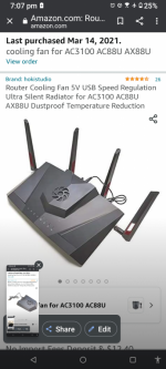

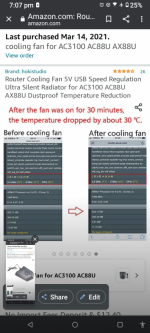

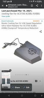

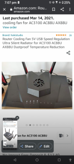

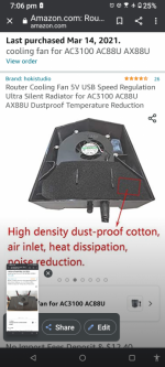

that temperature drop you mentioned it,as you pointed out,only on half speed if it's like my fan it will drop to the mid to high 40s on full speed
