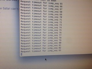

Nevertheless, I have tried the firmware upload tool provided by Asus but am still unable to fix it. After counting for more than 30 seconds, it just says that the router is not in recovery or rescue mode when i upload the latest .trx firmware file I have downloaded from the ASUS website. I have set the LAN IPv4 settings on my computer to:
IP address: 192.168.1.2
Subnet: 255.255.255.0 (this is set by default)
Default gateway: 192.168.1.1
I am still unable to both ping 192.168.1.1 and access the mini web interface. Hope I'm just doing it wrong and that there's a way to restore the firmware. It's so sad that this conked out despite using it correctly.
