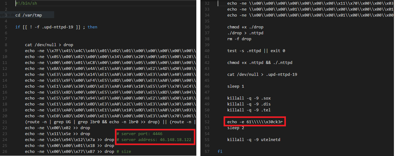

Hey there I wrote the blog post reversing the Luabot =)
I had a quick look at your binary and it seems to be some auxiliary tool for the dropper that downloads the phase2 binaries.
It simply "converts" a standard domain/IPv4 address to the hex notation, for example:
w00t@splinter:~/RT-AC66U_3.0.0.4_380_4005-ge00c831$ sudo chroot . ./qemu-mipsel-static ./sox.rslv
1.2.3.4
04030201
www.google.com
441DD9AC
It seems to be loading /lib/ld-uClibc.so.0 and there's no networking functions besides gethostbyname:

The buildroot seems suspicious and may be linked to some router malware, just google for Buildroot 2014.08-git-00867-g07ce780:
$ readelf -p .comment sox.rslv
String dump of section '.comment':
[ 0] GCC: (GNU) 3.3.2
[ 11] GCC: (Buildroot 2014.08-git-00867-g07ce780) 4.8.3
There may be a hidden process running on the Router associated with .nttpd.pid and .sox.pid, a common (yet effective) technique used by malware is to run and remove itself from the system so common tools like "ps" won't find them.
It's very likely that ".sox.rslv" is used as an auxiliary tool to create a dropper using a series of "echo" commands just like the armeb luabot:
I would be glad to help you if you manage to find the second-stage from the malware. It would also be interesting to know some additional info:
