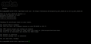

Copy and paste the full ca_cert_check.sh line into your routers SSH terminal an press Enter
curl -Os https://diversion.ch/scripts/ca_cert_check.sh && sh ca_cert_check.sh
If nothing happens after the above step, you will need to initially set your router to download in insecure mode from my website.
Paste this into the SSH terminal and press Enter
echo insecure >> $HOME/.curlrc
After this, copy and paste the ca_cert_check.sh line again. It should run now. The insecure mode will be disabled when completing the ca_cert_check.sh checks.

Version 1.2 of ca_cert_check.sh is now uploaded. This will work.
