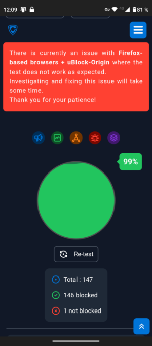

This is my result on my cellphone using NextDNS with these filters.
OISD
1Hosts (Lite)
NextDNS Blocklist for ads and trackers
AdGuard DNS filter
AdGuard Mobile Ads filter
Frellwit's Swedish Hosts File
HaGeZi - Multi NORMAL
OISD
1Hosts (Lite)
AdGuard DNS filter
OISD seems unnecessary because it’s included in HaGezi Multi Normal
