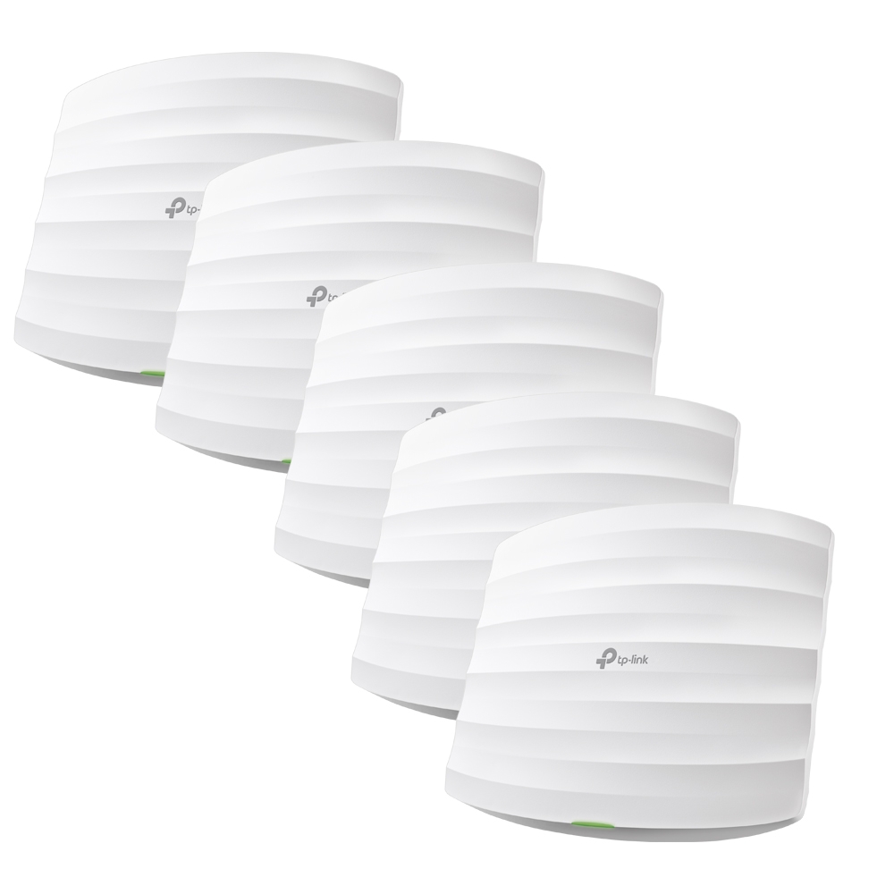

You only need an Access Point with PoE injector set to the same SSIDs* as your main router. Your mobile devices will roam between the two when they come closer to the stronger Wi-Fi signal.
one TP-Link EAP245 V3 (also AC Wave 2 class) is around $80-100. It even comes with the PoE injector and ready to go. Why you need to spend hundreds of dollars for a second expensive Router just to extend the Wi-Fi? And you have a wire ready in place.
Seamless Roaming is only supported under the use of Omada Controllers, and requires that clients need to support 802.11k/v and may require additional set up. Performance may vary depending on the client device.
W/O an Omada controller, you have to check if in the EAP245 it's possible to set the same local SSID as your main router.
Seamless Roaming
The roaming will be worse than all Omada APs with network controller, but will still work okay.
It is possible, of course. The AP has own UI and settings. The SSIDs can be set to whatever is needed.
