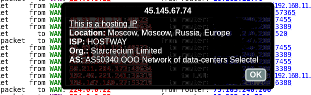

About the logs on web GUI:
1) IP addresses (from, then to) are aligned, so this create spaces. It was a design choice. Could have been without spaces but not aligned.
2) IP info clicking on it has been a feature since before 1.6. I think it does not work on some specific navigator or setting, but works for most of them.

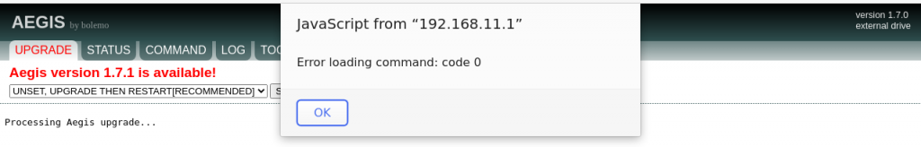

just did command line upgrade, performing all three steps each time.
first time went from 1.6.10 to 1.7.0 - all ok but the final version reported was 1.7.1
next from 1.7.1 to 1.7.2 all ok
web companion should say 1.7.3 available? but does not.
re-run of aegis upgrade -repo=stable asks if I want to reapply 1.7.2
Thanks for all the hard work on this amazing system for use on my R7800
Yes, I had the nasty bug back, so removed 1.7.3 to avoid problems.
It was on for a few minutes.
To be sure you don’t have problems (during next web upgrade), I suggest you redo upgrade from terminal, and say yes to reapply.
The 1.7.3 available now is ok, I completely changed the post install process.
I just upgraded via Web companion from 1.7.2 to 1.7.3 without issues.
Yep, 1.7.2 to up is working because it does not trigger the post install.
1.7.3 (the one that was there for a few minutes) fixed that but reintroduced the bug (no matter how hard I tried to go around it).
The actual 1.7.3 (the one you downloaded) has a totally different post-install process for web GUI. It is now a separate script loaded online in RAM with curl|sh.
For now, all that script is doing is setting up aegis settings for Orbi lighttpd if needed, it does nothing for R7800 and R9000.
