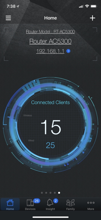

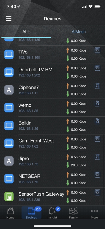

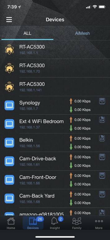

Here's what I see using the ASUS router app on my iPhone X. I see some wired and wireless but not everything which is connected.
Jim
Could you post the client list screenshot by Web GUI ?
Sure, first thing tomorrow morning. I’m in Miami, FL so its about time to go to bed and I’m on my iPad.
Jim
