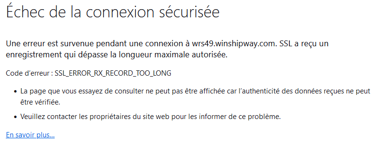

Same problem here with firmware 3004.388.6_2.
After testing the site, here's what it shows me in Firefox.
The site is blocked, but the Aiprotection counter is still at 0...
Another problem If I authorize the site, everything's fine. However, if I remove it from the list, it still works...
I don't think it's from Merlin, but if you could pass it on to Asus to fix these problems, that would be great.
It is your web browser. It should be http:// not https://
Log out of your router and test the link in private mode with http://wrs49.winshipway.com
Also if you have local access config to HTTPS, I don't think the AiProtection blocksite will work

It was Firefox's fault with the "HTTPS mode only" option. I deactivated it and went back to the site in question, where the AiProtection blocking window is now displayed.

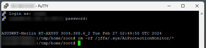

Before I do something stupid, does the command work with the latest version ? (RT-AX88U - 3004.388.6_2)
rm -rf /jffs/.sys/AiProtectionMonitor/*
Should be. I don't think they were any changes to AiProtection jffs database. Just follow the steps :)
So I disable the privacy, disable AiProtection and open putty, connect to the router and run the command, that's it?
So I disable the policy, disable AiProtection and open putty, connect to the router and run the command, that's it?
And re-enable AiProtection after running the command
Double Enjoy.
I've just carried out the manipulations, and the counter is alive again. How wonderful.
