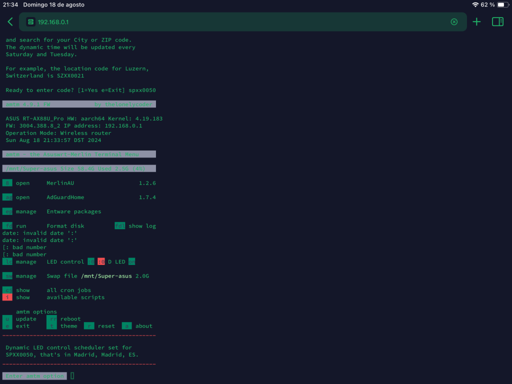

It doesn’t work for me
I made it again and when it download pakakes it says something like wrong, but message disappears
Gone haywire again for me today, dynamic time on/off showing as 0:00 and 0:00. Anyone else?
EDIT: Getting the same results regardless of city code, trying both ASXX0112 (Sydney) and ASXX0274 (North Sydney).
I am in the same situation.
Yep, me too. Noticed the LEDs were off as I walked past. SSH'd into my AX86U_Pro to find sunrise and sunset both set to 00:00.
Uninstall and reinstall of lc script didn't fix, hence my searching the forums and finding this thread.
