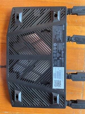

Interesting thread. One of the fixed Antennas on my RT-AX58U (actually it is an RT-AX3000) broke. I glued it but of course now it doesn't swivel.
Was thinking to replace with unscrewable Antennas.

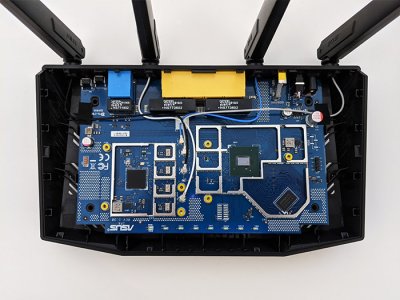

This reviewer shows the inside of one https://www.mbreviews.com/asus-rt-ax58u-review/
So my questions are:
1. Can you pop off the tails of those wires on the MB like the little clips common on Notebook Wifi boards; and
2. Has anyone actually taken theirs apart to see how big the holes are at the back, i.e can I get a big backing nut in there or am I looking at gluing a bracket so a small hole can be set up? A sleeve wouldn't work as the plastic is thin.

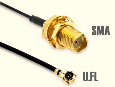

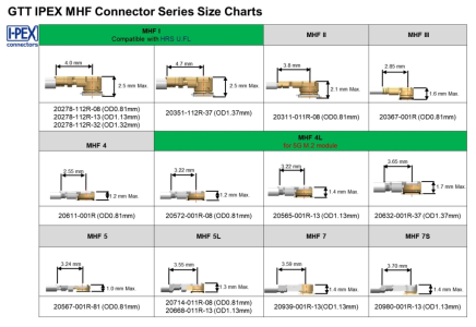

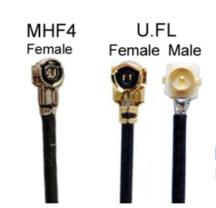

3. Anyone know the type of snap-on connector on the board? M or F? Size? I can choose the Antenna end probably RP-SMP is most common, I can buy an Antenna to match M or F of the RP-SMP connector, F or M respectively. MHF4 seems common?

OK, probably not a topic a lot of people are interested in but I’ll persist :)

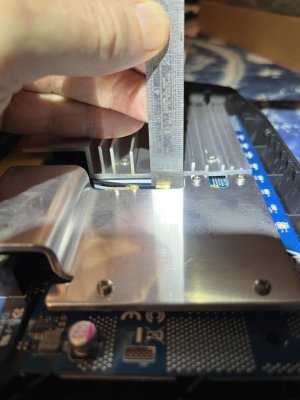

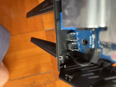

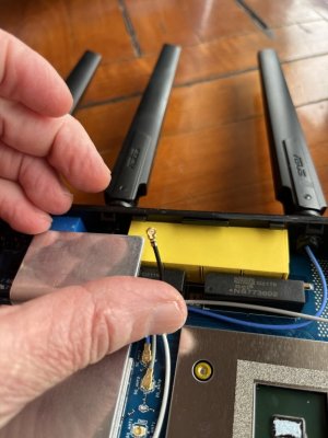

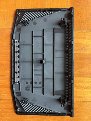

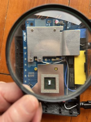

I took apart my RT-AX3000 (RT-AX58U) to check myself. 4 Philips screws under the pads, one has a “I saw you tampered with it“ pad on the screw. There’s lots of clips but working from the sides with a thin spudge then onto the back and pressing in the bottom half of the shell wrt the top part it comes apart reasonably easily, if done with care. No clips were broken in the dis-assembly…

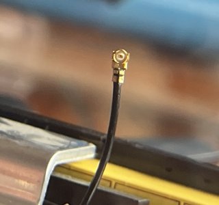

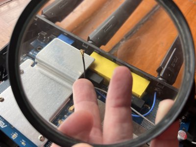

The PCB is held in place by the top half only so the board is loose in the bottom housing (care holding it upside down). It is also held in place by the 4 IPX to Antenna Wires, which are Black, White, Blue and Grey from L-R looking down from the top. I measured their lengths (insitu) as best I could for replacements they will be pretty close, 15cm, 12cm, 10cm and 16cm respectively. Probably get away with 15cm for that last one. I’ve found a source on Aliexpress for 10, 13 and 15 cm pigtails.
The connectors on the MB are stamped “37 IPX“ and after a bit of searching and measuring it means I have IPX Gen 1 (MHF1) ~2.2mm high female connectors on the PCB. The 37 denotes 1.37 coax (OD), which is apparently deemed relatively low noise compared to thinner wire.

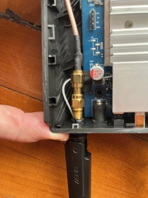

Looking at my other Router Antennas, they are all RP-SMA i.e. without the pin. The pin is therefore on the RP-SMA connector, which I will bulkhead mount on the lower case. Using this detail I get “RP-SMA female to IPX U.FL UFL 1.37mm Cable IPEX Bulkhead Mount O-ring Waterproof” on my orders, for the right lengths. Cheap enough to get a couple of extra to cover mishaps.
I’ll attach photos over this and the next posts. I’m not trying to get higher gain or anything like that, I’ve read enough about these just to know I’m happy with the current gain. What I’m doing it for is so that I can swivel the Antenna that was glued, currently it only works in wall mount orientation.
I’d be grateful for feedback on what is the closest to the original antenna that is a user-mountable one.

Additional photos. btw eagle eyed viewers will see that one of the photos above shows an RP-SMA connector held up against the plastic opening of the fixed Antenna connector, it is just to eye in the size of the hole. I think following removing of the plastic mount, it’ll fit the 8mm RP-SMA in there ok, hopefully not too much play.

The 37 denotes 1.37 wire (OD), which is apparently deemed relatively low noise compared to thinner wire.
Little error there. It's not wire, it's coax. Both it's inner wire and the screen must be connected correctly at both ends. Using normal wire would be lossy.
