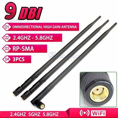

Really can't find lower than 5dBi, will it be a problem?
Here are 9dBi antennas with test result:
Recommended source for for wifi antennas that can provide measurements for show? Do these antennas vary in impedance, what spec do I need?
A problem? Maybe not, but look at the vertical dispersion: that's +/- 7.5-10 degrees. It would take 25' from the antenna before the pattern finally spreads floor to ceiling if it was stationed halfway high.
