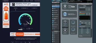

Thank you for the Answer. Yes it's the default, 1000Mhz / 666 memory.. when i do speedtest, the CPU from the Router is at almost 100% both cores. So i'm assuming i'm not getting the full speed from my ISP because of the router/cpu... Doing from the WebBrowser got those result's on the picture. While doing under windows app from Microsft Store, i can get more dowload 900Mb around. Both cases, the cores are at 100%. That's why i was looking to OC the CPU, that's the cheap way to do it. I will buy a new Router, but if i can save some money is perfect. So, you said also about HW acc? That's on the router right? Need to check that latter after work.

Your NAT acceleration is enabled. Otherwise you won't see above ~250Mbps WAN-LAN throughput. This router can do full Gigabit (~940Mbps) consistently only when TrendMicro components are disabled. You don't need to overclock anything. If you want AiProtection, Parental Controls, Apps Analyzer, etc. TrendMicro engine related functions at close to Gigabit speeds - a new router with ARMv8 1.8GHz cores.

Based on the screenshot alone, you have NAT acceleration enabled (the speed >300Mbps) and TrendMicro engine disabled (the low RAM utilization). In this configuration you can squeeze the max throughput AC68U is capable of. Your speed tests are good as well.
