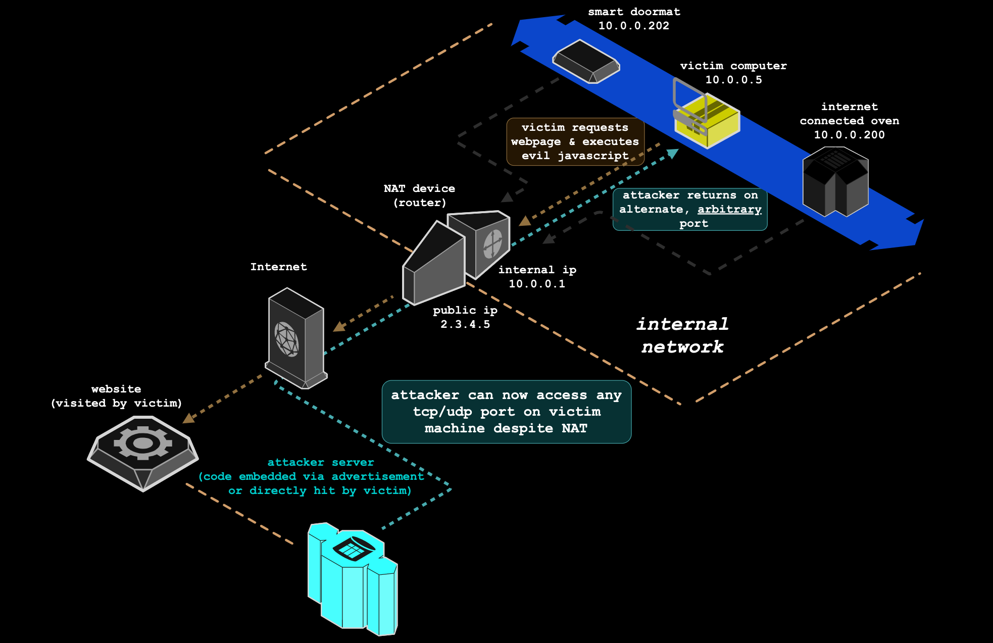

Are Asus routers running ASUSWRT-Merlin affected by NAT Slipstreaming? Mitigations?
ADFHogan
I posted here previously about this - and it seems my post was interpreted as "general security" and then shifted off into another forum.
I've made this post more specific.
... do we know if Asus routers running Merlin are vulnerable to this?
... if so, what mitigations can we deploy?
For now, I've turned off the ALGs that I'm not using to try and reduce the attack surface.
The author identified the following ALGs as potential candidates: sane (backup), sip (voip), pptp (vpn), and h323 (voip). He chose to concentrate on SIP as that seemed the most promising.
All four three of the relevant ALGs can be disabled on Asus routers in the NAT Passthrough options.
