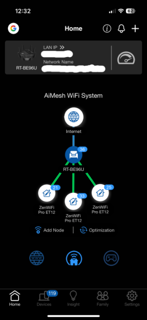

I upgraded my network from eero Pro to the be96u with zenwifi pro ET12's in an aiMesh, because of the fact the eeros couldn't handle the amount of clients I was using very well. Guest Network Pro has been amazing as well since I have a lot of home automation devices. The 6e and guest network pro with AsusWRT 5.0 has been a great upgrade as well as stability and security. If the features of the ax88u are enough, I'd suggest sticking with it, especially with the smaller amount of hosts that you have.
