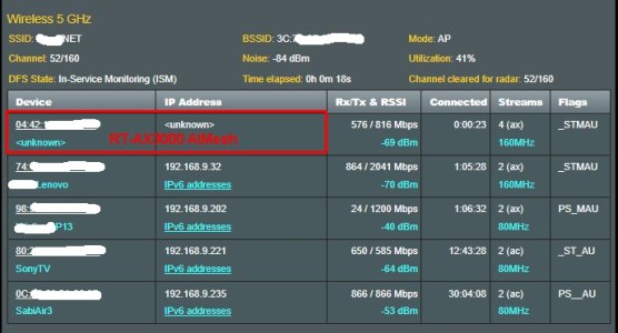

However I have noticed with some dismay that my AIMESH Node, whose IP Address (that I know) is defined by the AIMESH System and therefore I am loathe to add a reservation for it, shows both device name and IP Address as "unknown".
Is there a simple way to get the system to populate these Mesh Nodes with a name (that I can define or is at least defined in the Router by Model etc)? There is no way you get into the AIMesh Router WebGUI to give it a name (save to update FW and adjust Jumbo Frames). I can SSH into it, and use amtm on on it for the MerlinAU addon.
If it works, are there any disadvantages to adding the IP Address that AIMESH gave the node, to my DHCP reservations or will AIMESH just go and shift this (now reserved) address?

From the Router. It’s where I’d like it to show the name of the Node in the Router Wireless Log.

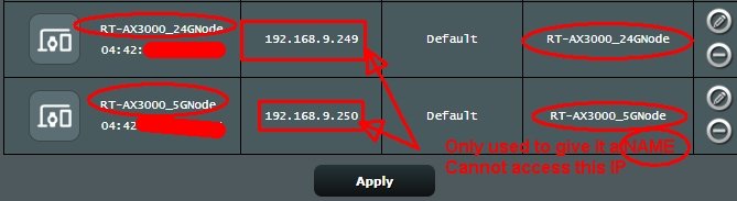

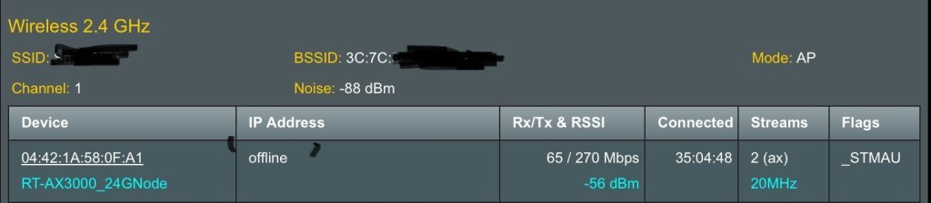

So, being curious about what would happen to the wireless log naming if I manually assigned an IP Address to the known MAC address, I went ahead and did that.
Bearing in mind that the mesh node is on 192.168.9.29 as assigned by the main mesh router, my trial was to see if I assigned an IP address 192.168.9.249 and 192.168.9.250 to the two MACs respectively,
  • Wireless 2.4GHz 04:42:1A:58:0F:A1
  • Wireless 5 GHz 04:42:1A:58:0F:A4
whether on reboot of the node, or of the main router (both of which I did), the node would pick up the assigned IP address of the (5GHz) Wifi Backhaul. It did not. Note I do not use a wired backhaul.
Instead, as shown in the attached picture, it retained the 192.168.9.29 IP address and shows the MAC as being A0 instead.
  • 04:42:1A:58:0F:A0
I was going to do one last try and reset the node to see if when I re-added it, it switched to the assigned IP but when I saw the A0 I decided against it.
What did come out of this though, is that the Wireless Log now actually shows the name of the device I reserved under LAN DHCP, so rather than just showing a MAC Address and an “unknown” device (as it did before), it now shows the MAC and a real name. So that’s useful. No idea what happens to the two reserved IP addresses, they are not accessible. I guess they just become name placeholders as far as this exercise goes.
The devices are both shown as being “offline” in the IP field even though they do appear connected.

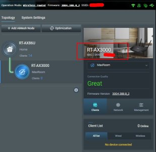

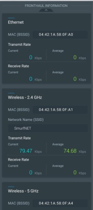

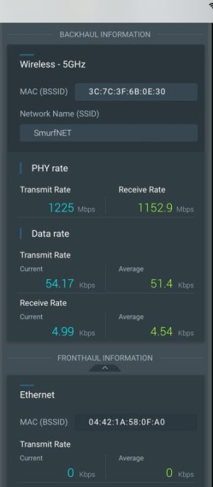

If you’re looking to change the IP of the AIMesh Node to what you want, you need to find and assign the ETHERNET MAC in the WebGUIs LAN, DHCP Manual Assignment, but it’s not intuitive at all as that address never shows up in the dropdown list. You need to find it. So where is it?
Well it is in the AIMesh Menu, just select the AIMesh Node and at the top of the RH menu, in the picture is the MAC Address of the Node; it is an Ethernet Address, NOT a Wireless one regardless of whether you have a Wired or Wireless Backhaul.
Note that whilst the Wireless log might show up s 2.4GHz and 5GHz device (which incidentally you can also manually assign an IP Adrress) neither is the AIMesh Node MAC Address.
Folks on wired backhaul will be better placed to accept the AIMesh Node MAC as the MAC address you use to assign your preferred address (once they work out where it is), but those on wireless will be going “huh???”, especially as the Wireless Log doesn’t have any IP addresses but still shows the “unknown” devices.
It’s like ASUS said “here’s AIMesh, it’s all a big secret”. There’s a lot of folks saying “don’t mess with it” but once it’s all connected up and the routers and nodes have been introduced to each other there’s no reason why these “new neighbours” can’t “move house”, if you will; they’re still the same people, they now just live at a different address.

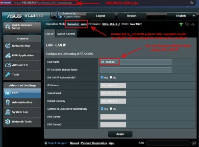

(b) For this item, see Here and Here for the background. Essentially:
"You can access the GUI of a mesh node by running in that node ssh session the command 'nvram set re_mode=0' before acesssing its login page. Remember never to run 'nvram commit' (this includes any action in GUI which could commit) with re_mode set to 0 since it is reported to cause problems. When you are finished just run 'nvram set re_mode=1' to return to a safe state."
What happens is that this CLI command, which you issue via SSH, makes the menu appear as if the AIMesh Node was a Repeater i.e. it IS the repeater menu.
You can then go into (LAN, LAN-IP Tab, Host Name field) and change the host name of the node to what I want it to be.
On mine, originally it was RT-AX3000-FA0D or something and I changed it to just RT-AX3000. Hitting Apply made me lose AIMesh but the router still came up at my (new) IP address and I changed the setting 'nvram set re_mode=1" (i.e. back to 1) and the mesh node came back.

(c) For Renaming "unknown" AIMesh Devices in Wireless Log (for easy identification)
See above pictures, but simply put, on your main router, LAN, DHCP, Manual Assignment, assign an IP Address (and names) to the MAC Address of the "unknown" devices you see in System Log, Wireless Log.
They will STILL show as 'offline', but they are NOT (as shown by the Rx/Tx & RSSI details and Streams columns). But at least you can see what the device is (as per manual name given by you, based on the Wireless MAC). You cannot access anything using these assigned Wireless IPs, they are for naming purposes only.
