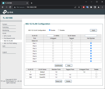

Many thanks to everybody that pointed in the right direction: VLANs. I am using two Asus RT-AX1800U in AiMesh config with two guest wlans (one 2.4GHz and one 5 GHz).
I hope that it will help everybody: here is my TP-Link TL-SG108E switch config

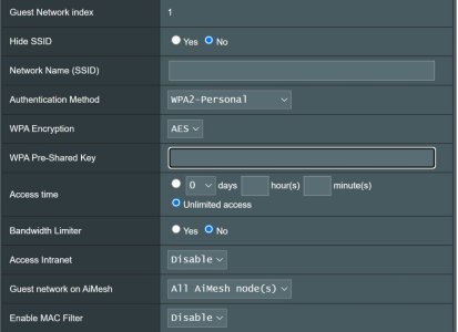

I'd like to provide a brief update on how I solved an issue with my guest Wi-Fi not connecting to the internet. Initially, the problematic configuration was as follows:
  • NAT Acceleration: Disabled
  • Guest Network 1 Access Intranet: Disabled
My initial workaround was to enable NAT Acceleration, which successfully provided my guest devices with internet access. However, this resulted in a limit to my internet speeds, approximately capped at around 300.
Based on suggestions from others, I found a solution that involved reconfiguring my guest Wi-Fi networks, specifically Guest 2 and Guest 5. I moved Guest 2 from the first column of the Guest Network settings page to the second column, and Guest 5 to the third column. This change enabled me to set NAT Acceleration to 'Auto'. Consequently, I was able to enjoy Gig download speeds again.
This configuration change allowed devices on my guest network to access the internet while remaining isolated from my primary internal network.
I hope this solution proves useful to others who may encounter similar issues. I spent quite some time figuring it out, so I'd like to thank everyone who offered their assistance!

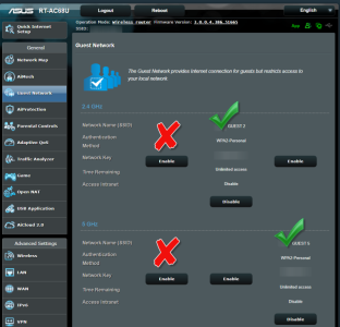

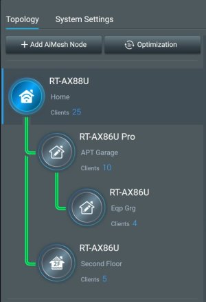

I know that this thread hasn't been active, however, I figured Id give it a shot. I've attached a pic of my mesh network. I've completely rebuilt it by resetting all routers to factory settings by holding the wps button and then turning on the power; all routers are at the latest firmware. I've rebuilt this network twice now by adding one node at a time and testing it. All of the nodes are hard-wired with Cat6e, I have 1 main switch that is a managed switch but I have not created any VLANs. I have never been able to get any of the nodes to broadcast my guest network through many firmware upgrades. I've read through all of the solutions in this thread, I cannot find a "nat acceleration" setting in my router's configuration or manual. Any other advice or suggestions?
