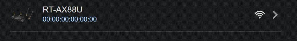

Hello Everyone. Ran into a bit of an issue that I can't solve, but hoping somebody here could offer some suggestions. My wife bought me an Asus RT-BE88U router and I went through the normal setup process to set the router up as an aimesh router, no problems. I then added an RT-AX92U as a node and had zero issues. I then attempted to add my RT-AX88U router as a node and the MAC address keeps showing that it is zeroed out and will only connect as a client, not part of the network. Another odd thing is the RT-AX88U router still attempts to connect to the network via wifi, even when it is hardwired. Having done various troubleshooting operations, I can always get the RT-AX88U to work as primary router, but never a node. Any thoughts or suggestions would be helpful.

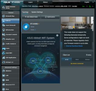

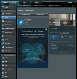

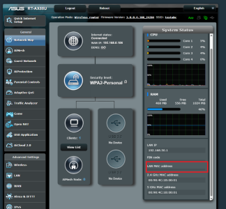

My situation is similar, the rt-ax88u works fine as a wireless router. When configured as an AIMesh router or AIMesh node, the Lan MAC Address will show all zeroed out (see attached photos). During the AIMesh setup, it will only show up as an wireless node ( not wired one !) and the setup failed at the end. Is it a hardware problem or software problem ? I have already tried out different versions on Asuswrt and merlin software but the problem remain. Please help.

It seems there are quite a few of us with the zeroed out mac address on our Rt-AX88u routers. Supposedly there was a firmware fix for this but it did not work on my router. I still got the zeroed mac address. I think whatever happened broke the hardware.

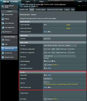

In order to execute the code, you need to access the console of the router through SSH services. To do so, first go to the "Administration menu", then choose the tab "System" and then enable the ssh through "lan" .(see attached photo)
After enabling the SSH services, you may login the console and execute the code.
This "trick" only works when setting the rt-AX88u as an AIMesh router or an AIMesh Access Point, setting it as an AIMesh node is out of question because there is no way you can "access" the router after changing to "AIMesh node" ! Also, you need to redo the whole process again after every firmware upgrade !!
