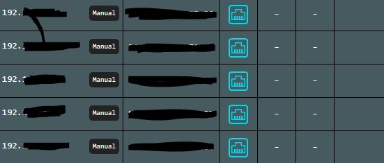

where exactly is that? I can't see any RX rates. I have wifi radios turned off anyway on my AX89X... using an ET12 as AP.
Well I had another look and unfortunatelly I can't see any RX/TX rates on my AX89X. All of them are connected by cable to the router via a 10g switch. On the ET12 AP same issues... only wifi RX/TX rates are shown. Any ideas?
Oh it's likely as you turned off your AX89X wireless.
RX = receive rates of your wireless devices (like iphones and laptops), which also means the wireless signal sent out by AX89X
TX = transmit rates of your wireless devices, which also means the wireless received by AX89X
Newer revision of AX89X is said to use faster qualcomm radios than the first generation, i was hoping to know how your B2 works.
Oh, ok. I thought RX/TX should show up also for wired connections. Would have been nice to see at which lan speed a device connected.
