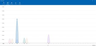

Hey guys,
sorry that i reactivate this thread, but i don't want to make an seperate one, because in my opinion its the same topic.
I attached an screenshot from all the Wifi's in my neighbourhood.
The question for me is: which is the best fixed channel that i can choose?
But the problem is, that sometimes the channels from the other Wifi's changed or some Wifi's disappeared and later they appaers again (i think the neighbours are use the Automatic Channel Selection)
Thanks for reading and answering.
Have a nice weekend.

Hey Guys,
sorry that i reactivate this Thread, but i don't want to make an seperate one, because in my opinion its the same topic.
I attached an Screenshot from all the Wifi's in my Neighbourhood.
The Question for me is: which is the best fixed channel that i can choose?
But the Problem is, that sometimes the channels from the other Wifi's changed or some Wifi's disappeared and later they appaers again (i think the Neighbours are use the automatic Channel selection)
Have a nice Weekend.
At least at that location all of those signals are so weak it doesn’t really matter. But the only real way to know is try one. If you are unable to use the upper bands, 149+, just try whatever looks clear and see if you have any issues.
