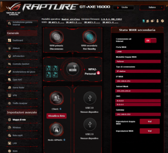

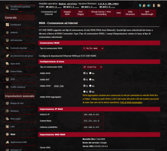

Hi, I have configured the dual Wan on the Asus GT-AXE16000 router with Original Firmware. I assigned to the primary WAN the configuration assigned by my ISP with PPoE and to the Secondary WAN the access to a second 4G/LTE Router configured with a static address 192.168.0.253 in the WAN2 side subnet.
However when I try to access the Router address 192.168.0.253 connected to the WAN2 port via its IP address I cannot reach its GUI.
Where am I wrong?
Attached are all the configurations I set.
Tanks

You are not doing anything wrong. That's how it's meant to work. In Failover mode only one of the WAN interfaces is active at any one time. The inactive interface is "down" and therefore inaccessible.
