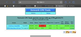

How to solve the problem of incorrect display of the voltage scale? shows the scale from -20 to 20v, but in fact there is 220v. screenshot attached

What Client software are you using? I use WinNUT, so I can't help you. That said, if I know what Client software you are using, perhaps a google search will help.
That is cool. I'll have to look into the package. As I said, right now, I use WinNUT for monitoring the UPS status. Only thing that I can suggest right now is seeing if there are any conf files that go with the cgi package. Perhaps there are range settings there.
the problem is that the second ups displays the values correctly. And to be honest, I don't know where to look for the problem anymore (((
