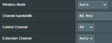

Hi!
I have applied the previously suggested settings and it looks like working. However my router is acting up and I'm not 100% sure it's not defective.
