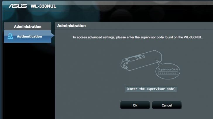

Yeah, but on the WL-330NL, one logs into WebGUI via the supervisor code - and I bypassed that completely by going to the hidden page... and better yet, on the WL-330NUL, the admin password...
can't be changed in the WebGUI...
One can change the WPA/WPA2 passphrase... at the same time, the Guest Network is open, and depends on the portal.

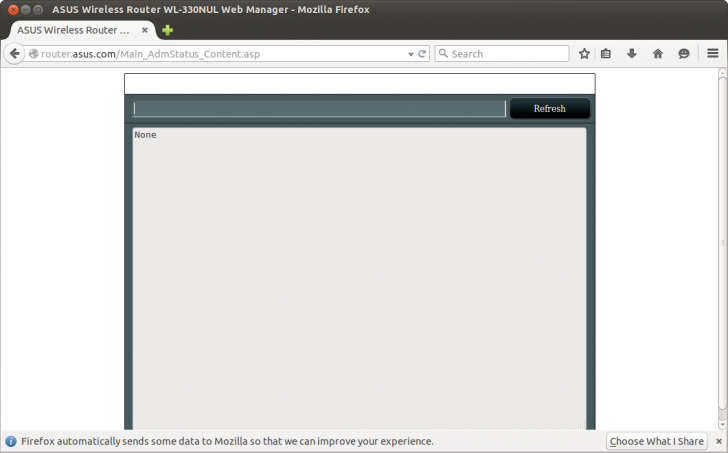

The design issue here is that without authentication at all - that hidden page, it's a shell interpreter... I can type in any legal command there, not just enable telnetd
In other words, broken by design...

So, still in the same browser window, we type in the following URL (again, this is on the Guest Network)
http://router.asus.com/Main_AdmStatus_Content.asp - see below
I type in the window - telnetd, and press return...

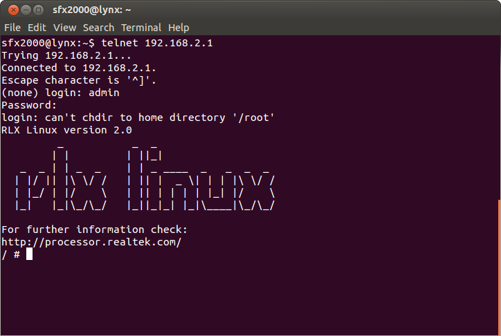

Go back to terminal - in this case, the client IP is 192.168.2.8, so I telnet to 192.168.2.1... and here, it's not the supervisor code normally needed to access config, it's admin/admin
yes, think about that... and think about it again.
That's right - I now have a command line shell on the router, running as a privleged user..
This is how Asus treats your network, the data you attach on the USB drive, VPN tunnel coming in, etc.. etc.. etc.
Really easy to break security.. and cheaper to implement right the first time
