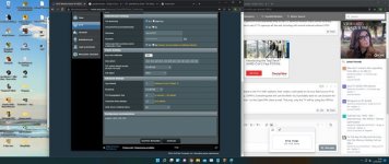

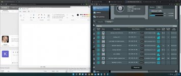

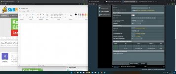

This is my configuration and not working... Sorry to be new to these things, I had to go abroad for a long time and very much because of me that it would help. Thank you
You have to select VPN Director for the "Redirect internet traffic through tunnel" option on the OpenVPN client if you expect to use the VPN Director.

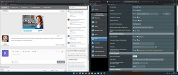

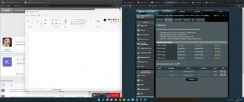

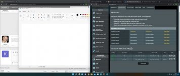

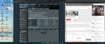

Now, VPN is on, and im have on all devices normal internet without vpn. What am I doing wrong? I see that I am ever closer but still far away.

In your policy rules, leave the remote IP field blank. You only need the local (source) IP field. The remote (destination) IP field is only if you want that source IP to use the VPN for a specific destination IP.
Try getting rid of that cipher directive in the custom config field. Normally the OpenVPN client shouldn't require anything in that field.
When im delete this he cant connect to the VPNclient
I can see the same ciper in the data-ciphers list, but perhaps they're using an older version of OpenVPN that doesn't recognize anything except the cipher directive. If that's what it requires, leave it there.
What you might try doing is verifying the VPN works at all by instead changing "Redirect internet traffic over tunnel" to "Yes (all)". At that point, every LAN client should be routed over the VPN. If that doesn't work, then there's some other issue that's yet to be identified.
