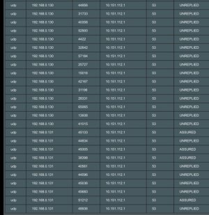

This might be a lead: the both devices (192.168.0.130 and .131) apparently do send out some requests to the VPN DNS server, which is IP 10.151.112.1, but the majority gets the status “unreplied”. Maybe the DNS server does not reply, or not in time, causing the router to resolve the requests locally. Weirdly enough I have 0 of such issues with other devices connected to this VPN.
That's not really the way this should work.
Wireguard redirects dns using the router firewall. So all packets from your .130 & .131 ip with destination port 53 should be dnat (change destination address) to wg dns. The router doesn't know if it works or not. If wg dns is not responding it should appear as broken connection on the client.
So, how could your clients send dns requests to the router and seemingly bypass this rule? Ipv6 usage is one reason.
I see, my internet connection indeed has a native ipv6 connection (which I do not wish to disable). Thanks for your help and information! Fingers crossed that in a future FW the DNS Director will cover both ipv4 and ipv6.
