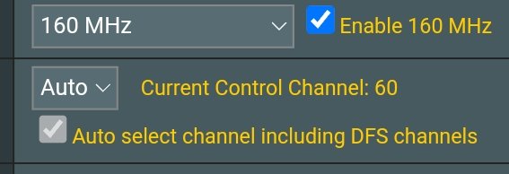

I'm good I've tested speeds on 20/40/80 160mhz off, 20/40/80 160mhz on both 👎, I've tried many different varieties and only way like I've said that my speed tests have reached above 1100+ mbps is by only having 160 mhz on....

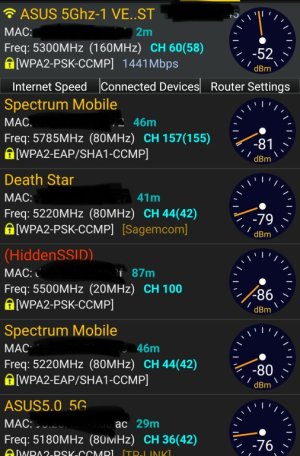

Oh I just checked my router settings and it automatically picked channel 60 which is a dfs channel, and I'm getting above 1100 mbps on speed test now I'm thinking that maybe my speeds results drop when the router picks a number in the 3 digits not so much because it's Dfs channel...
So you many be asking me why don't I just manually pick a channel that has gave me very good speed test results, well I've done that and after a while my speed test aren't even above 1000 mbps. So I must have only 160 mhz on and auto channel on and hope router picks a good channel... But I wish I could unchecked the box that says Auto select channel including DFS channels
You can and should so that non-DFS clients can connect period using a non-DFS control channel. Of course, the non-DFS control channel band/frequencies will be more populated by other networks around you, so your all-important speed test may suffer while your network waits to share the non-DFS control channel and related frequencies with other networks.
As to your wish, accept that the firmware is flawed and does not support changing settings in every possible sequence. If you change the settings around a bit, you will discover that you can set 20/40/80/160 or just 160 and a fixed or Auto non-DFS control channel (exclude DFS channels). You just need to try/find/get to the desired settings in the sequence the firmware is coded to respond to... otherwise it takes you into a settings dead-end and false conclusion that you can't get there from here... I have found that you can on my models (I've seen the firmware do what you are referring to... like some websites, ASUSWRT and its derivations are broken in more ways than one... endlessly so).

Based on the best setting on 5ghz with only 160 mhz on I cannot I cannot unchecked the box Auto select channel including DFS channels
My devices are fine they are able to connect 9 devices on 5ghz and 15 on 2.4 ghz
