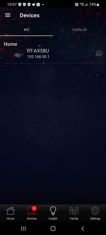

For me I upgraded with the GUI option and it worked fine; I haven't upgraded my firmware in a long time, so the version I came from I don't know exactly but it was probably at least 12 months old. The new version seems to have improved the speed for my primary devices like my phone which seems to have gained nearly 100 Mbps.
So far the connection seems very stable and I was having some strange glitches with my Nvidia shield (before update) that seemed to be resolved after updating.
The only issue I have noticed so far is that I do not see any of my clients connected in that Android app.. the device I'm writing this on is connected and working great but the only thing I see is the AX58U.
I would call myself an intermediate user and have by no means tested all of the functionality but just wanted to add my experience and the missing client issue to the repository.
I would call myself an intermediate user and have by no means tested all of the functionality but just wanted to add my experience and the missing client issue to the repository.View attachment 41046View attachment 41047
