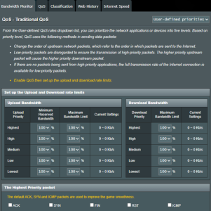

If you try the Stock Firmware, when the slowdown is occurring, make sure to check this and disable everything (ACK, SYN, FIN, RST, ICMP) and set Maximum Bandwith to 100% on everything, and Apply. No need to reboot, soon (almot immediately), when your Bandwidth returns, then go ahead and get back on Merlin.
Had QoS Off and Application Analysis Off but the BWDPI (TrendMicro) engine would randomly start and because these setting were in place they got used 🤦‍♂️.
Under Merlin or Stock, did the same, in the exact same way. When it started up my 940Mbps U/D went to 400Mbps until a reboot, then it would ramdomly drop again until the next reboot, and so on. But solving it was a little trickier, at least for me.
I later found out, that with the scMerlin addon the Traditional QoS gui gets exposed (even if set to off) and made sure I disabled it all, see the two Advanced_QOS options and if anything is on, turn it off.
Not saying this is your problem, though you're describing what I went through almost exactly. May not be the answer fo you but it was and it worked for me 🤷‍♂️
Was in the early days of 388.x and it drove me bonkers trying to figure it out, you can find my threads on the subject if you search.
Never did figure out how it was set, but because I was't looking I never saw it, again QoS was set to Off so why would I look 🤔 but look I did and turned it all off and got the Bandwidth back immediately.
Good Luck, let us know what you find...
Thank you for this! I haven't gone back to the stock firmware yet, and if I understand you correctly, there's no need if I use the scMerlin addon correct? The same settings will be exposed that I need to turn off as highlighted in your first screenshot?
EDIT: I see that scMerlin is quite old and the github page doesn't state whether or not it's compatible with the latest firmware. Can you confirm it still works? Or would you recommend me going back to stock, disable the settings and then dirty upgrade to Merlin again?
EDIT 2: I've added the scMerlin addon and disabled all the QOS options that you highlighted after the default QoS GUI got exposed. I'll remove the daily reboot and report back in a couple of days.
Thank you! I haven't enabled any of the AI protection features (didn't see the need), but I do get a popup during setup to accept these terms. I have now withdrawn consent. As to the second part of your post, I've addressed this in point 5 of my opening post. A config file is never used during my setup either way.
I use scMerlin for some specific things, and not very often at that, but yes it works, see below...
"if I understand you correctly, there's no need if I use the scMerlin addon correct? The same settings will be exposed that I need to turn off as highlighted in your first screenshot?"
Yes!, at least it did for me back when I dealt with this early on in the 388.x life cycle. I don't remember if AiProtection had an impact as I never really enabled for any significant length of time.
