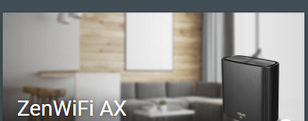

Mine also looks like this:
My icon look like yours, but changed to the real one after clic on it:
Updated with no problems at all, although I only have one XT8 with about 30 devices, no mesh.
Strange, I can't change the icon, not even after a factory reset from the Webgui.
Have you perhaps done a factory reset using the WPS method?
Tried to clear the cache browser or another browser? I never did a reset and the icons are ok on my two different xt8 installations
I have been using Asus routers for 8 years, and I have never ever done a factory reset prior or after updating firmware. I know it is an usual practice here (I do not understand why), but I have never needed it, because I do not want to enter all settings again (dhcp reservations, ports, etc.). Once I did one, just to "try" that wps method, not in an upgrade process.
