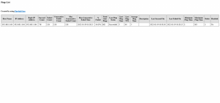

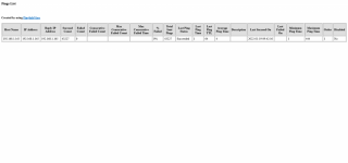

It's not good. 42095 is stable, ping several hours, and 0 packet loss. 46061 keeps losing packets. The software 42095 connects to 5GHz only, the newer software including 46061 connects to 2.4Ghz and 5GHz simultaneously and that's probably a problem.
