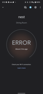

So I spoke too soon about the scheduled reboots fixing all my Nest Thermostat problems. This morning I woke up to my app saying ERROR! I'm guessing the error or issue with the router and Nest Thermostat happened after my nightly reboot.
Also this didn't give me the typical "Can't get weather" error.
That’s too bad. Though that kind of error is different from what I’ve seen before. Looks more like an issue with the thermostat.
