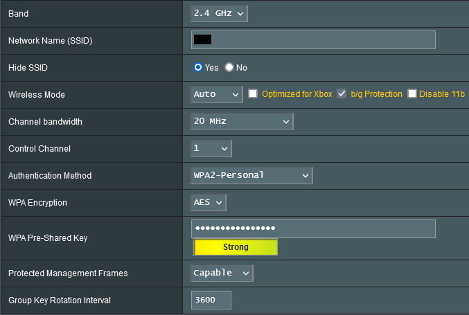

After reading through this thread and seeing the multiple reports on 2.4 GHz WiFi not working I decided to investigate and indeed it isn't working for me also (i.e. my iPhone 6 cannot connect to it). Strangely, my sister's Asus RT-AC661 B1, which I updated remotely and which uses the same firmware as my Asus RT-AC68U, doesn't seem to have this problem, at least not with the clients she's using, a Motorola mobile phone (don't know the exact model, E6 play or something like this) which only has 2.4 GHz WiFi and an old Toshiba laptop (with a Core2duo cpu) which I believe is only 2.4 GHz capable as well. Other phone and laptop are 5 GHz capable and should work at least on this frequency.
I tried many different thing, short of resetting my network setting on the iPhone (which may very well have solved the problems, but for not wanting to lose the various saved WiFi profiles I didn't do) and couldn't make the phone connect to 2.4 GHz WiFi. I've rebooted the phone and forgot the WiFi network, also used a different SSID and password on the router but to no avail, it doesn't connect.
On the router (always using 20 MHz, channel 1, WPA2-Personal and 3600 seconds group key rotation interval) besides the aforementioned different SSID and password, I've tried: Wireless Mode: Auto, Legacy and N-only; disable 11b option (which once enabled I could not disable, unchecking the box and hitting Apply button would result in the checkbox returning); Protected Management Frames: Disable, Capable (the setting that I'm using); Preamble type: Short and Long; DTIM interval: default of 3, tried 4, 50; Modulation scheme: MCS7 and MCS9; Airtime Fairness, Explicit Beamforming and Universal Beamforming: Enabled and Disabled.
I also tried cold booting the router, resetting the settings, formatting jffs and the usb flash drive (all further tests were done without the flash drive connected). I reset the settings both from WebUI and by holding WPS button from a cold start until power led started blinking.
After rebooting with all settings wiped, the phone would connect to the default, open "ASUS" ssid; but as soon as I changed it in the WebUI wizzard, so just a different ssid and with a password, it would no longer work.
Tried older firmware 386.3_2 and 386.2_4 (just to see the wireless drivers) and both worked.
I also tried the two latest stock firmwares, version 3.0.0.4.386.45934 from 2021-11-16 and version 3.0.0.4.386.45987 from 2021-12-16, WPS resetting every time, also cold booting. The former, 386.45934, exhibits the same behavior as 386.4_0, which is the iPhone could not connect, while with the latter, 386.45987, the iPhone can connect once again.
I've downgraded my Asus RT-AC68U to 386.3_2, restored the setting, restored jffs partition, plugged in the usb flash drive, rebooted and waiting on the next alpha once RMerlin receives an updated gpl from Asus and has time to merge it and compile it.
Edit: I've upgraded to 386.4_0 again to test using the smart tv and the phone and long story short now I can reliably connect both the tv and the iPhone to the 2.4 GHz WiFi as long as Disable 11b is not checked. If I check it and hit Apply, I cannot uncheck it from WebUI, as I previously said, but it can be done from the terminal:

With Disable 11b checked, the two nvram variables are set to ofdm; I checked the Asus RT-AC66U B1 and it has the two variables set to default.
I don't know how my earlier tests failed since after a reset these variables are set to default, but nevertheless they did.
These are the settings I use now for 2.4 GHz:
Edit 2: I'll make a new post and link it here once it's done.

I've done more testing after ~30 hours of the phone remaining connected to the 2.4 GHz WiFi, and can say that my previous testing was wrong and as such my reporting on it was also wrong, for which I apologize.
It seems that every time I tested and the phone could not connect, I actually checked the Disable 11b checkbox. Testing again either one of AsusWRT-Merlin 386.4_0, AsusWRT 3.0.0.4.386.45934 or AsusWRT 3.0.0.4.386.45987, all hard reseted by holding the WPS button, the phone connects as long as I don't apply the checkbox and fails to connect if applying the checkbox.
More over, applying the Disable 11b checkbox sets the nvram variables wl_rateset and wl0_rateset from the default values of default to the new value of ofdm and cannot be removed using the WebUI. It can be done from the terminal by executing the following commands:
nvram set wl_rateset=default
nvram set wl0_rateset=default
nvram commit
service restart_wireless
