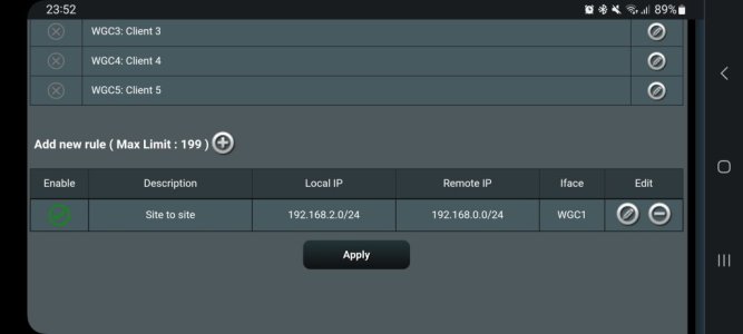

How is your vpn director rule? Did you put in source 192.168.2.0/24 there?
We could make a script that removes this entry automatically, but Im not sure we should. Or atleast you should test this extensively before we do it so there are no side effects.
Yes it works. Thanks
You can see the results in the last attachment
I put this rule (see attachment)
So the cap that you said before about 500 Mbit/s can be related to my VPN speed? (same value about 500 Mbit/s)
Is the Broadcom chipset the problem?
I'll test this change in the next days

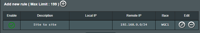

without the local ip (see attachment) same upload problem
I removed the rule with the command:
echo "del 192.168.2.0/24" >> /proc/blog/skip_wireguard_network
Alright, altough you could keep your rule without the local ip, it is the proper way imo.
Except from general router stability, up/download speed, keep an extra eye on the syslog in the gui. Lookout if it gets flooded with error about blog or similar. Try to provoke by sending/recieving large files over Wireguard.
Let me know when/if you are confident enough to make this entry removed on wg start.
