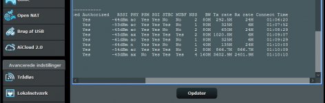

I have an AX86U as my main router and i am using a AX58U in Media Bridge mode (connected to my sons PC).
After a "fresh" reboot of the media bridge and then main router (in that order) i get Tx/Rx link rates at around 3600Mbbps/2400Mbps (see attached picture, bottom row).
After a day or two the link rate drops to around 2400Mbps/1200Mbps (Tx/Rx) and eventually to 1200/1200. NSS also goes down eventually to 2 instead of 4

OK, but what are your wireless settings on the AX86U? That is where I would look with AiMesh or media bridge mode. As I understand, gamers seek low ping rates. You just might do better with his built in AC adaptor and the AX86U set to WPA2 and 80 MHz on 5 GHZ.
Your main router switches from 160MHz to 80MHz. Lock it on 80MHz and don't use DFS channels. AX58U has Gigabit ports only, no need to push it to 160MHz anyway. Your son can use the built-in AC Wi-Fi just fine. 2-stream AC with good signal can reach >400Mbps. Games will run the same way.

Link speeds above 2400Mbps exceed Gigabit port throughput. Link speeds above 867Mbps (2x2 AC) won't make much difference on your 400Mbps ISP. 160MHz and DFS channels only lower your connection reliability without adding advantages. The AX58U router is not needed. It doesn't make your son's gaming much better. In both cases (internal adapter or Media Bridge) you have a Wi-Fi connection to the PC. Wired is the best for gaming, but as you said your son is not a pro or a competition gamer.

That screenshot was taken right after a reboot so not all devices were connected (and it's only for the 5GHz band).
