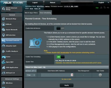

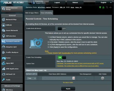

Yes appears to possibly be hardware/router specific on how many clients are supported. On a couple of RT-AC68U's, one running Asus stock 3.0.0.4.386_51685, the other running Asus-Merlin 386.14, the Client List max is 16 for both.

Yes, not surprised. This model and multiple variants have limited NVRAM available. Last time I checked it was about 10KB free after clean boot on stock Asuswrt. The reason RMerlin reduced the number of VPN clients in Asuswrt-Merlin from 5 to 2 in 386.11 firmware.
