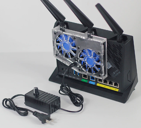

Although I am not running real hot, I am considering getting a fan such as the ones on Amazon for the AX86u. Has anyone used one and does it work?
Good point about the dust. When I seen the fan for a specific model AX86U made me wonder if they have a heat issue or is it just generic fan that fits a lot of models and they use model numbers to get hits.
I don't see AX86U cooling fans on Amazon. I find some for AC68U and AC86U only.
AliExpress has this thing, if you really insist to spend some money:
It appears to be about the same as the one I found on Amazon.
https://www.amazon.com/dp/B08PNY4GFM/?tag=snbforums-20
I have found many times Amazon fails to give you what you are looking for unless you get the search words just right. Even then, it also has shows some strange things that do not relate. Oops getting off subject here. I will wait on getting one (if ever) as the point about dust is a valid one. May consider one if the temps get higher as mine appears to be the same range as others. (46c - 50c - 73c)
I see nothing AX86U related there, sorry. Just some fans of different kinds.
Okay, I see it now on Anazon US. Similar to the one from AliExpress. I have zero hits on Amazon Canada. Still, not needed.
