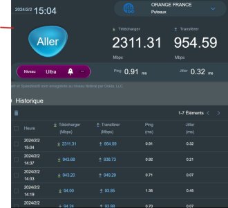

With the Asus firmware 3.0.0.6.102_33308 : 943Mbps
With the Merlin firmware 3004.388.6_0 : 94Mbps

i used this website for everytest :
https://www.speedtest.net/fr/result/15835399854
same MO and same equipment (S22 ULTRA connecter with wifi AX, ROG laptop with Wifi AC) for each test
options were totally the same between 2 firmware, except of course if Merlin add some specification
you can see all the test made in the router on this picture.
the switch from asus firmware to merlin, to asus again, is obvious in the result !!!
i don't understand !!!
