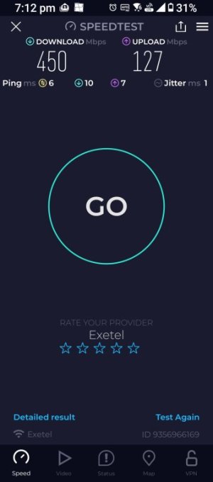

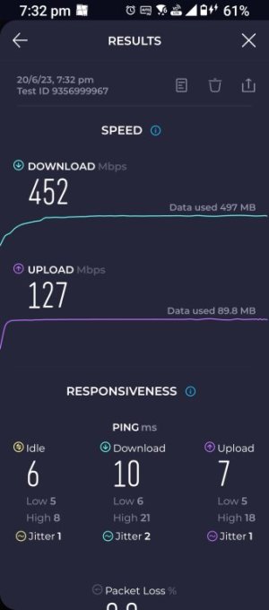

I got 500/50 Mbps connection but I usually get around 540/190mbps.
in QOS I did manual speed setting. reduced it 470/130 Mbps. added my phone's real Mac as gaming device.
got great ping reduction.
my down/up ping is greatly improved. especially upload. I don't personally care much about loosing some speed but consistent ping.

I understand this shouldn't be the case but somehow gt ax6000 just wanted to push out highest of the speed but no consistent ping otherwise. I tried reducing it in increments of 10 until I got consistent ping rate. I also understand there are people with far better expertise in this area with better explanation. all I did so far is just played around with my routers different settings pretty much everyday.

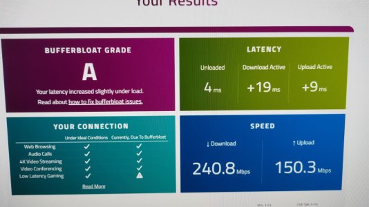

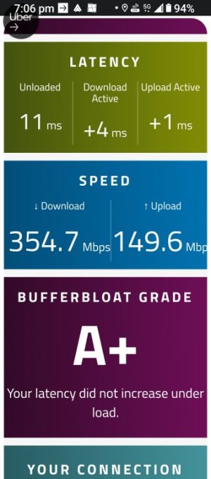

Don't understand why I am getting better result on wifi than the PC
Is the PC assigned a static IP address and have you created a rule for the PC if identity as a gaming device?
Hi King. yes I have assigned permanent IP for PC/phone and created gaming rule for both. somehow connection not being constantly good on both however Phone is getting really good results on tests see below. sometimes it requires router rebooting in order to have results in line. I must be missing something here.
