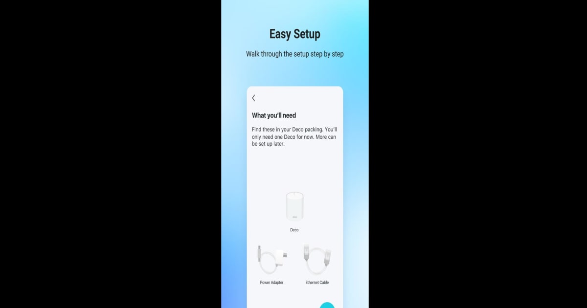

I can say that TP-Link does not bother creating a Deco emulator because you open the settings and it feels like there's nothing to configure
Deco doesn't have Web interface. App control only.
Interesting option to run Deco App on a computer though:
Otherwise TP-Link Emulators website is quite impressive. There are hundreds of devices from different product lines. ASUS have none. Just one very old Asuswrt 386 demo and one with the new 102 UI.
Hmmm. Pretty sure Decos do have web interfaces. In Access Point Mode they're even more bare:
