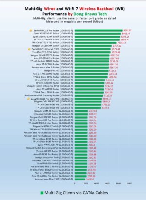

so there are no differences in performance? I saw this graph
What I know is you have to be very careful with what firmware options you select on such devices because all of the above can't process even Gigabit traffic with no NAT acceleration enabled. They are tuned for power efficiency with similar to RPi hardware and fast ports. The throughput is "up to", conditional, not guaranteed. The reason I asked you what the use case is and you replied "It doesn't matter". Black Friday will reduce your wallet contents for sure, but will it work up to your expectations or not - I don't know. For guaranteed 10Gbps speed you need hardware in thousands with x86 firewall appliance, 10GbE switches with 10GbE NICs on clients and multiple APs on different channels doing eventually aggregate multi-Gigabit speed to multiple clients.
