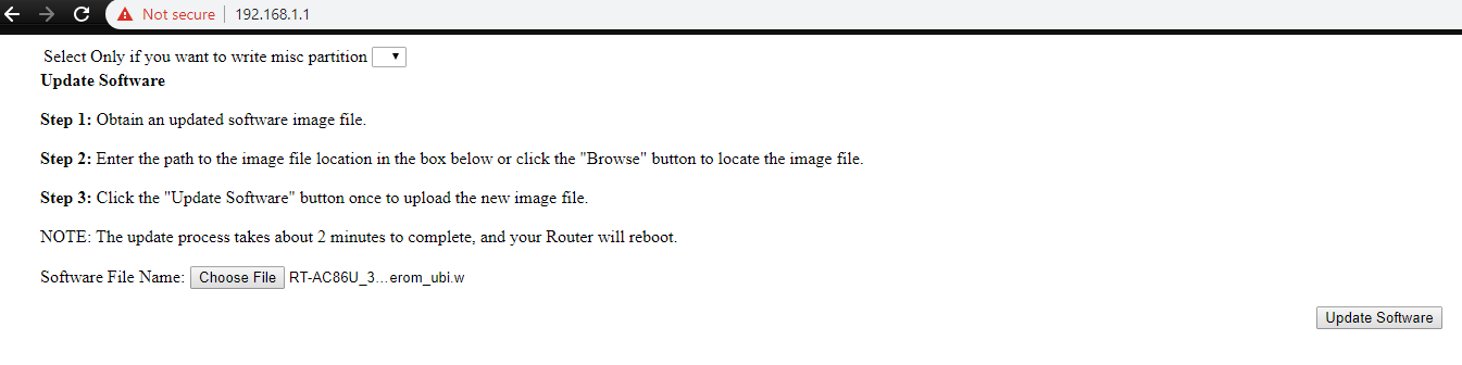

Just purchased one RT-86U from Amazon Warehouse. I think it came bricked. Power led flashes once every 25-30 seconds. Already tried Asus Firmware restoration utility and it didn't help. It finishes successfully and nothing happens. Also tried holding WPS buttton and turning on the router. In this case all leds went off and I'm able to reach 192.168.1.1 and I see this
Tried uploading latest firmware through this UI and it didn't help too. Is it dead dead? Or it could be restored with some bells and whistles?
I got an RMA. It wouldn’t restore even though I’d upload the firmware through that page.
