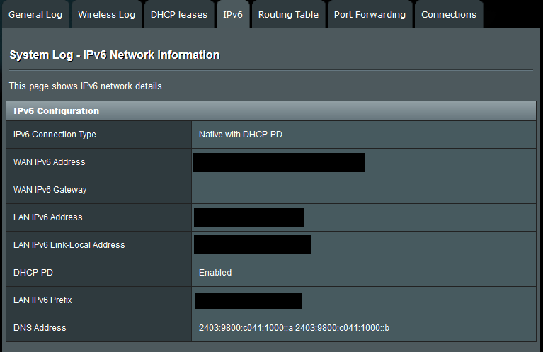

My ISP has just enabled IPv6 and I seem to be having the same problem with not receiving a gateway address. My ISP is also providing /60

This. I have had to just do the same to get IPv6 native to work. Pulled address details down ok from ISP but gateway was empty. LAN clients had correct IPv6 details but no internet connectivity.
Did this via SSH on the router, connectivity now working across the LAN (and router, ping6 failed there too for example):

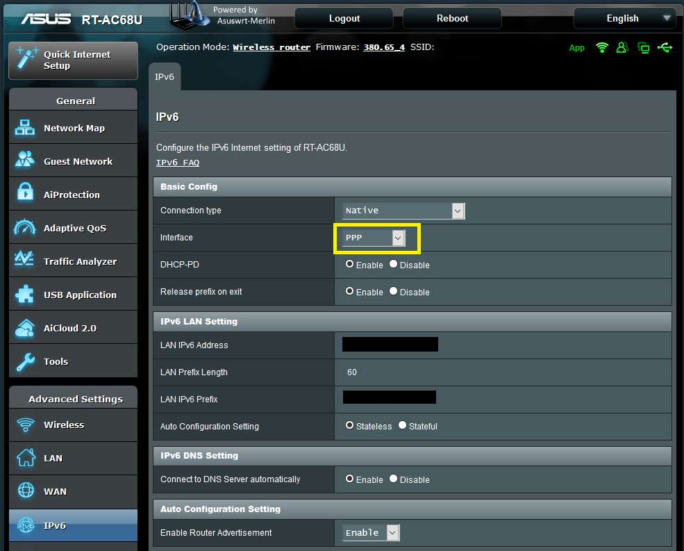

Thanks for the update.
For me I had IPv6 set to use Ethernet instead of PPP. Once I changed this to PPP the gateway address came through correctly.
