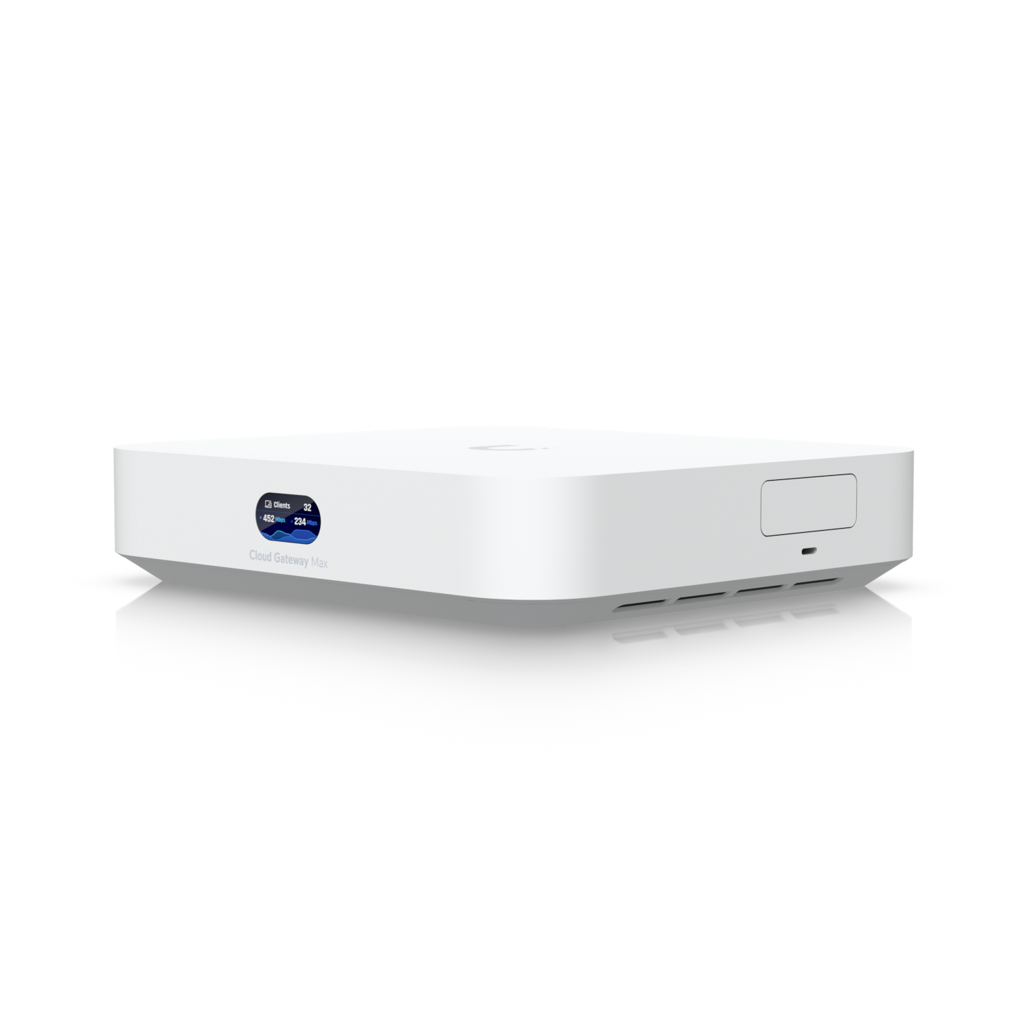

This specific one disappears the moment it shows in stock, very popular. Up to 1.5Gbps WAN-LAN with IDS/IPS enabled, full 2.5GbE without it and on LAN-LAN switching. For $200 there is hardly anything better. The software is excellent end easy enough even for beginners. The online documentation and built-in help are good enough. If concerned about the operating temperature - place it on a laptop cooling pad or something similar. If you need more than a flat home network - get VLAN capable switches and APs. The same for Firewalla above or other OPNsense/pfSense appliances.
