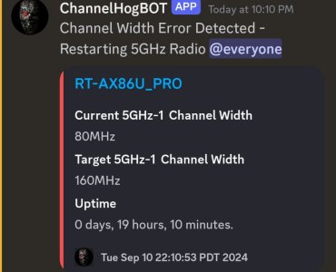

I think I got it installed correctly when I choose option 1 start channelhog I don't get any error message so that's a good sign
I began to notice on my RT-BE88U, when I install channelhog and checks of the bandwidth is changed, it detects it has, although it already set to 160mhz bandwidth?
It shows that ChannelHog detects 80mhz, although on the app and WiFi analyzer shows it’s fully 160mhz, but it restarts 5GHz for no reason, every time, you ask it to check it see its current. I think it might be a visual bug, unsure or if the addon isn’t getting the current information of the bandwidth, it always auto detects as “80mhz” although it’s 160mhz, regardless of restarting.
