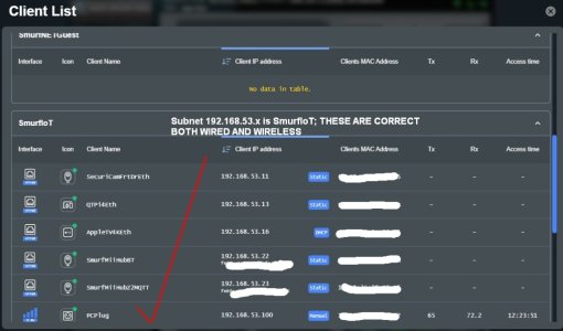

The two issues I am seeing are these:

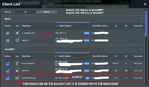

  1. Referring to the client list accessible from 'Network Map', 'View List', I am seeing devices I have assigned to VLAN 53 'SmurfIoT' (Manually Assigned addresses e.g. 192.168.53.109) AND that have attached themselves to a mesh node, show up (incorrectly) in the client list of the Primary LAN (SmurfNET) which is my 192.168.9.x subnet. Conversely, VLAN Clients that latch on to the Primary Router Wi-Fi appear to list themselves correctly. I also see that any time a device on the IoT Subnet (VLAN 53) moves from being attached the Primary to the AIMesh Node, it moves from SmurfIoT to the incorrect SmurfNET list, hence it appears to be a Node or AIMesh related issue.

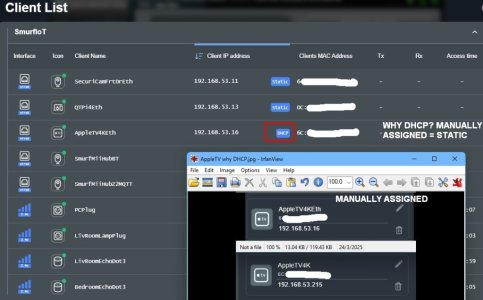

  2. A second issue with that list is that some (mainly wired) clients show up as DHCP, however these have ALSO been Manually Assigned a Static IP Address, so I consider this behaviour to also be incorrect. See example for AppleTV4KEth on 192.168.53.16 (note I have a separate entry for the Wireless MAC).

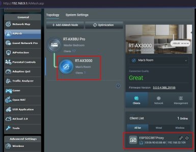

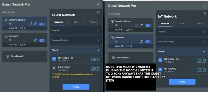

Asus support apparently indicates the following (in bold).
2. This feature can only be configured on the AiMesh router. Guest network is currently designed to allow the first set of each band (2.4G, 5G, 5G-1) available to the AiMesh node. Only one set is available for each band.
If I remember right there was an other lengthy discussion in this same subforum a while back on trying to get 3006 Guest Network Pro features on the main router to flow down stream to AiMesh 3004.x firmware non Guest Network Pro routers and the results were mixed.
