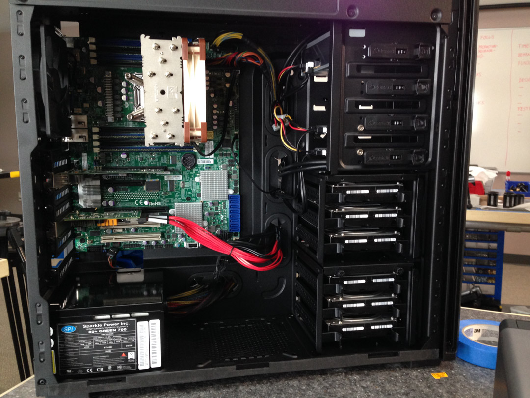

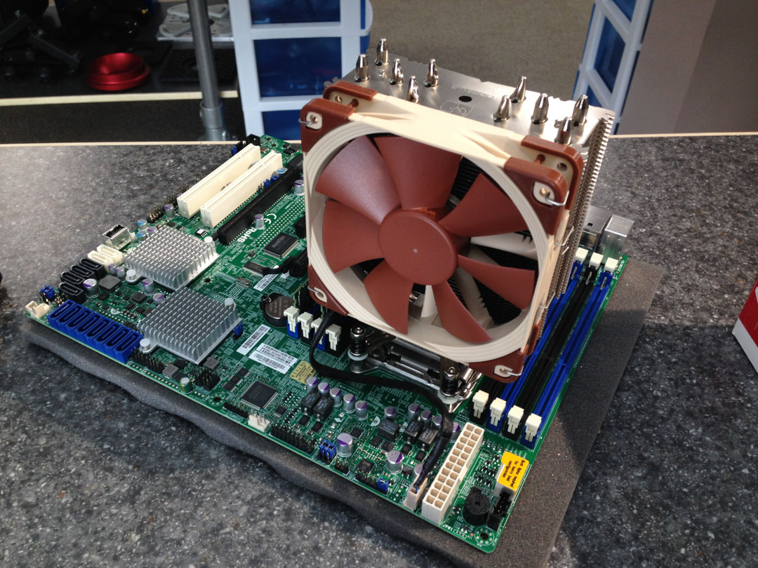

Some sneak peaks of the Windows 2012 "NAS" build. This board may be the best buy right now in terms of an ATX format board with 10GbE as it incorporates 2 x 10GbE ports on board, provides 10 x SATA3 ports, and 4 SATA2. I'm using an inexpensive (but fast!) RocketRaid 2720 to connect the 6 x 4TB drives in RAID5. You're looking at about $2500 including the 7200 RPM 4TB Hitachi drives, 16GB ECC registered RAM, and a six core Zeon E5-2620v2 processor. The processor has max TDP at 80 watts, six cores and 2.1 to 2.6 Ghz speeds. There is ~ 20TB usable in RAID5, with reads in the 900MB/s range, and writes in the 450MB/s range. A nice balance of efficiency and speed.

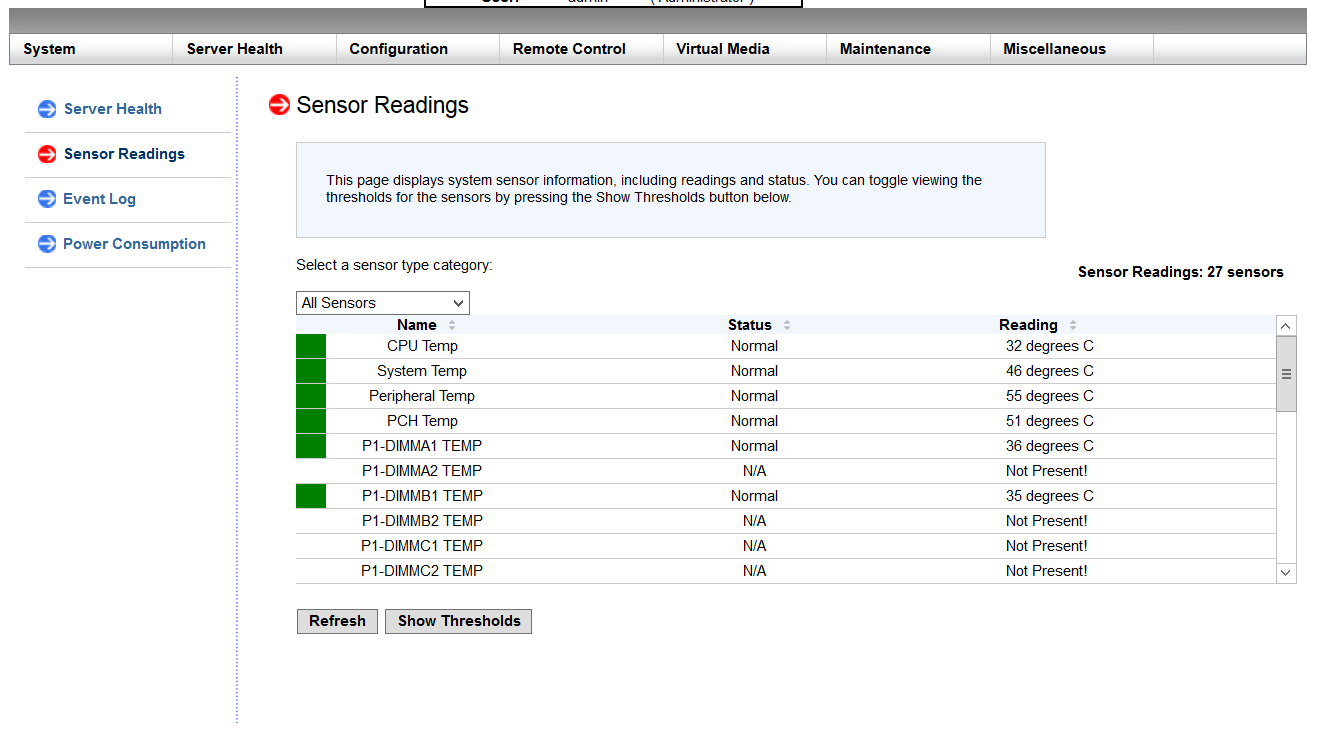

The last screen grab is from the onboard out of band management. This board, like many server boards, has a third LAN port that when connected, provides a virtual KVM. You can boot the computer, view bios screens, update bios and monitor system parameters just as if you were sitting in the front of the computer. Hardware alerts (like a failed system fan, or temp range exceeded) can be emailed from that system, even if the OS is not booted.

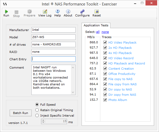

Two Windows 8.1 (I am using 64bit, Pro) workstations returned 1.48GB/s during RAM drive file transfers with two 10GbE ports connected in an SMB3 multichannel test. In other words, a NAS based on Windows 8.1, a fourth gen i7 processor, a $150 Z87 or Z77 chipset motherboard (I tested the Asus Z87-A, and Z77-V) will saturate a 10GbE connection, and indeed take you well beyond that if you run multiple connections.
The i7 3770K slightly overclocked to 4.3 Ghz on an Asus Z87-WS motherboard, with 32GB Gskill 1600Ghz RAM, is the fastest PC in my tests. That said, the 2.1Ghz (2.6 Turbo) E5-2620 v2 Xeon chip in the Supermicro (six physical cores) in my test server is idling along at 25% or less during 1GB/s file transfers. Much of this is due to the RocketRaid 2720 RAID controller which relies on system CPU. There is a misconception in the Adobe CC video editing world that a dual CPU Xeon system with a ton of RAM will outperform a single i7 4770K processor system. The Adobe PPBM tests I am using show that the i7 systems are faster, and often for 1/3 of the price. I guess the moral of the story is to do a bit of research before throwing money at a workstation :-)
The only significant downside I could see using Windows 8.1 over Server 2012 (with regard to 10GbE network speed) is the limit on SMB3 connections for Windows 8.1. This is set at 20 connections. Windows 8.1 also does not allow NIC teaming (a feature built in to Server 2012), however you don't really need this where SMB3 multichannel is concerned.

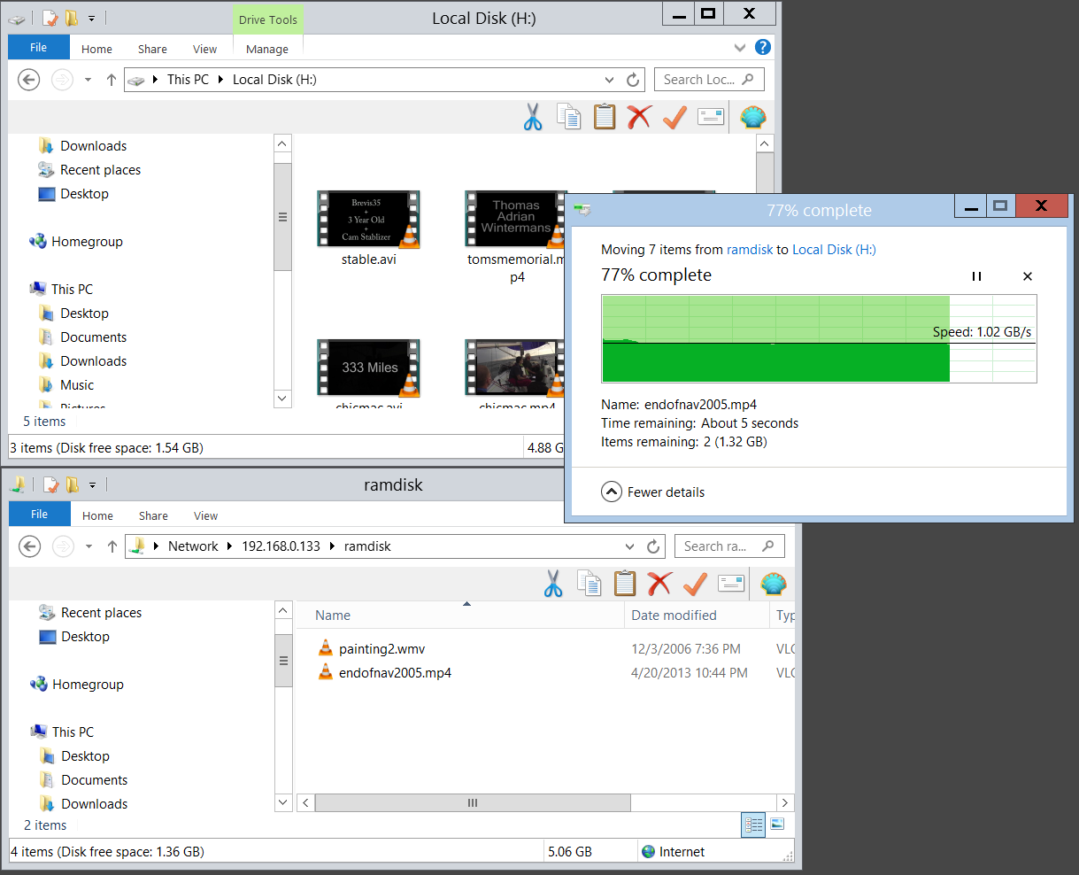

I've sent in part 6, but here's a screen grab or two. Both machines were running Windows 8.1 64bit. Both workstations were sharing RAM drives (using SoftPerfect Ramdisk) to remove disk IO as a limitation. With Intel 530 SSD drives in both, the max possible would be 450MB/s or so due to Sata3 limitations. If both were sharing newer PCIe SSD drives, then you would see the full bandwidth as below using RAM drives.
