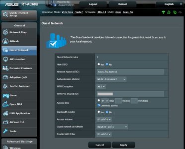

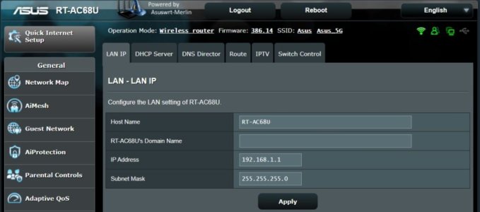

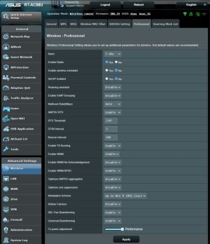

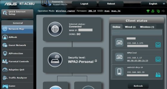

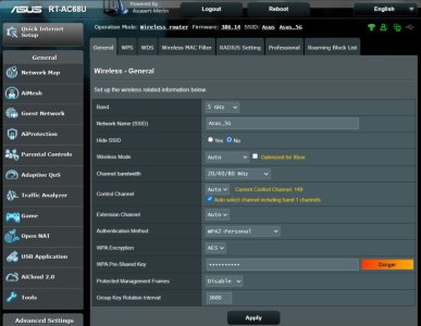

Did a very quick and dirty test with a RT-AC68U running 386.14. No AiMesh or AP nodes. Hard factory reset the router and did basic initial setup. No scripts installed. Used same password for Wireless Guest networks both main LAN WiFi and Guest Network Wifi. Setup Guest Network WiFi #1 both 2.4Ghz and 5Ghz. WiFi set to WPA2 with generic SSID's for WiFI (Asus, Asus_5G, ASUS_Guest1, ASUS_5G_Guest1). Main LAN configured for 192.168.1.1. All other settings at default.
The Guest Network #1 clients could not see each other (ping and SMB) and could not access a NAS (both ping and SMB) connected to the RT-AC68U's network LAN port. The Guest Network #1 clients appeared to be properly isolated and could access the Internet/WAN. Main LAN client (wired PC) could not see Guest Network client (ping and SMB)
