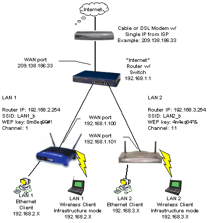

Hello, I wanted to ask something about connecting 3 routers to a house, this is the idea I have:
main router "1" of the isp company (in bridge mode) = I manage it
router "2" connected by cable to "1" = I manage it
router "3" connected by cable to "1" = managed by someone else
I have some questions, first of all I have NOT yet bought the router "2", my budget is about 170 eur, my questions are:
-Is it possible to connect 2 routers to the main router?
-Any router that allows the isolation of a Lan port With another Lan Port? (For router "2")
-According to what has been said, is it possible that someone can sniff traffic with techniques like "MITM"?(for example the person who manages router "3")
If so, how could I avoid it?
Thank you all !!!

main router in bridge mode will have only 1 output and to connect 2 routers you would need to have a very good management switch - traffic control/ split/ QoS etc.
Not true in all cases. My ISP with their modem/router in Bridge Mode provides 2 separate IPv4 external addresses on ports LAN1 and LAN2.
Yes, you have 2 options:
- if more than one external IPs are available at the modem, the two routers connect to the modem and create 2 separate networks
- If only one external IP is available, the ISP device has to work as modem/router, the two routers after connect in double NAT
In both cases Router 2 and Router 3 devices don't see each other. In double NAT Routers 2/3 see Router 1 devices, if something is connected there.
I'm assuming you're asking about home routers. As standard option - no. As custom configuration with custom firmware - yes.
: Yes it is possible.
-If so, how could I avoid it?
: Impossible. That's why the internal enemy is always dangerous.
Yes it is possible.
Don't scare the guy for no reason. A person on Router 3 network can't access Router 2 network. Router 2 network guy has to help him.
This is only true for traffic inside router 2 network.
Traffic from router 2 to router 1 can be easily seen by the managing entity of router 3, unless VPN is in place to cross out of router 1.
If router 1 has 2 ethernet interfaces then you could isolate router 3. And by having 2 interfaces I do not mean a switch but actually 2 interfaces with 2 different IP belonging to 2 different networks.
Not easily. Average users have no idea what are you referring to.
