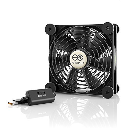

Well, here's what I did for my RT-AC1900P (the BestBuy version of the AC68U):
I ordered one of these - AC Infinity MULTIFAN S3, Quiet 120mm USB Fan for Receiver DVR Playstation Xbox Computer Cabinet Cooling
from Amazon for $12.99 - I plugged the USB-A connector into an unused USB port on the back of the router, stood the fan on its rubber feet, and directed the airflow onto the back of the router. Here are my temps as I write this:
Temperatures 2.4 GHz: 39°C - 5 GHz: 42°C - CPU: 51°C
It ain't fancy, but it works for me...
